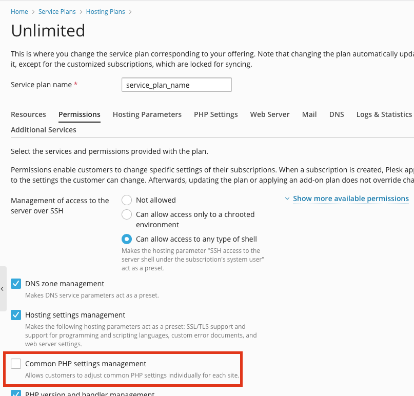

On the Service Plan level:
- Navigate to Service Plans > service_plan_name > Permissions tab.
- Enable the option Common PHP settings management:
- Click on the Update & Sync button to apply changes for all the subscriptions under the selected service plan.
Note: Changes will not be applied for the Locked subscriptions

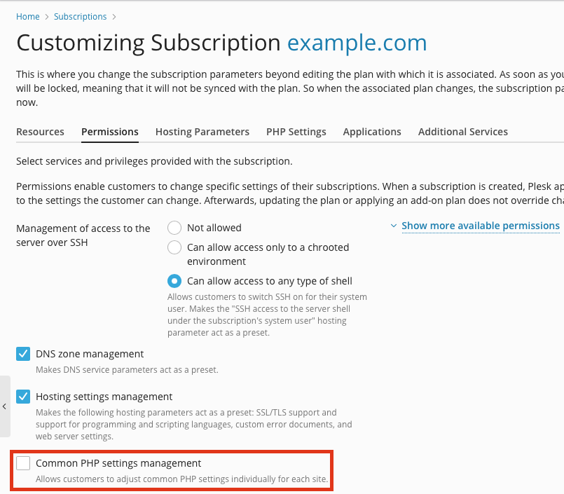

On a Subscription level:
Warning: After applying changes on the subscription level, the subscription will be locked from the synchronization with its service plan

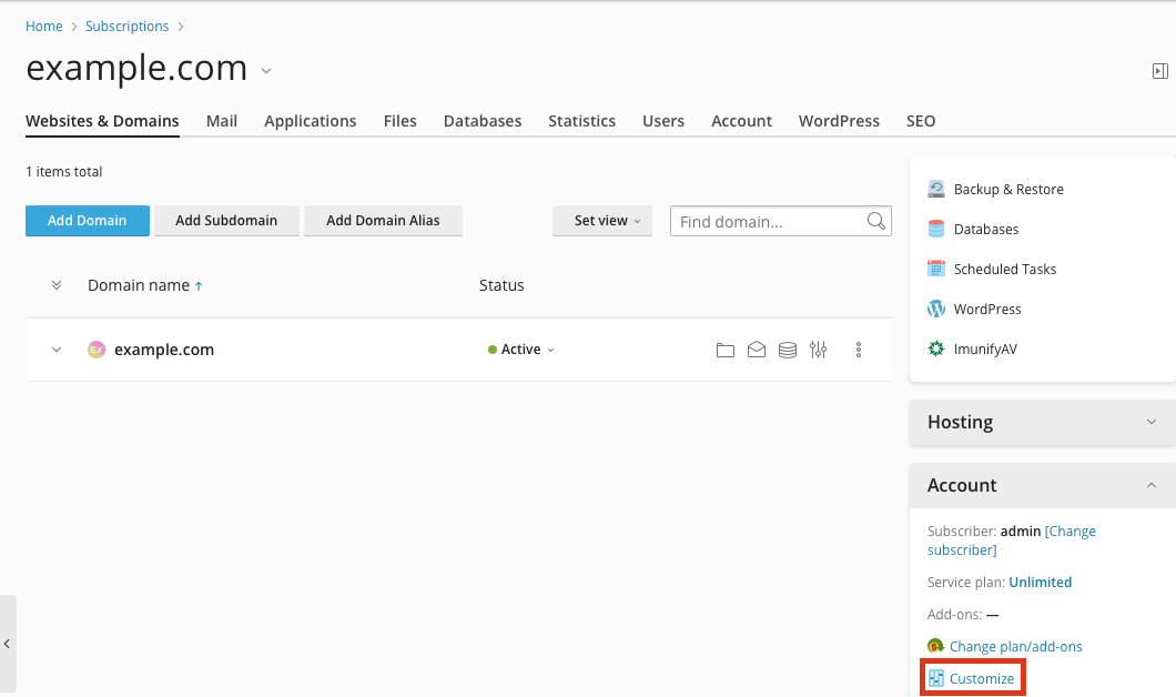

- Navigate to Subscriptions > example.com.
- On the right navigation pane click on the Customize link:
- Switch to the Permissions tab.
- Enable the Common PHP settings management permission:
- Click on the Update & Lock button to apply changes.
