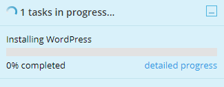

Question
A task (scheduled task, WordPress installation, extension update, etc.) is stuck in Plesk. How to stop this stuck task and close the "tasks in progress" window?
