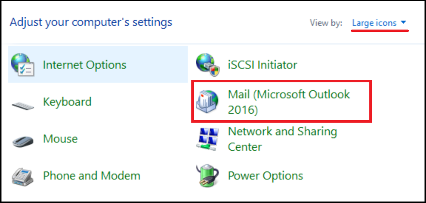

- Go to Start > Control Panel > Mail:

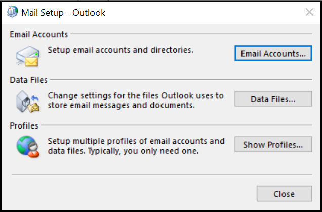

- Press the Email Accounts... button:

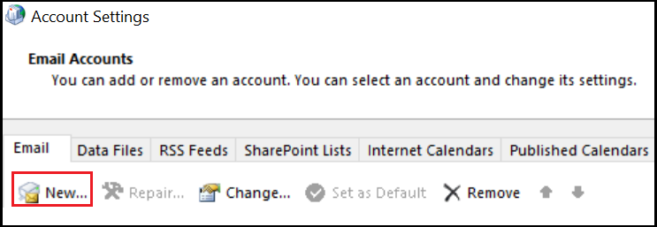

- In the Email tab press the New... button:

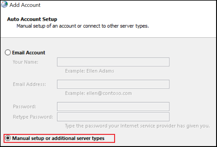

- On the new appeared window select Manual setup or additional server types and press the Next button:

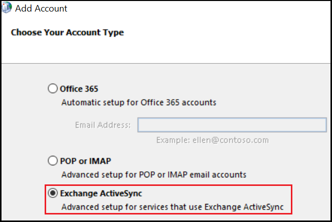

- Select Exchange ActiveSync and press the Next button:

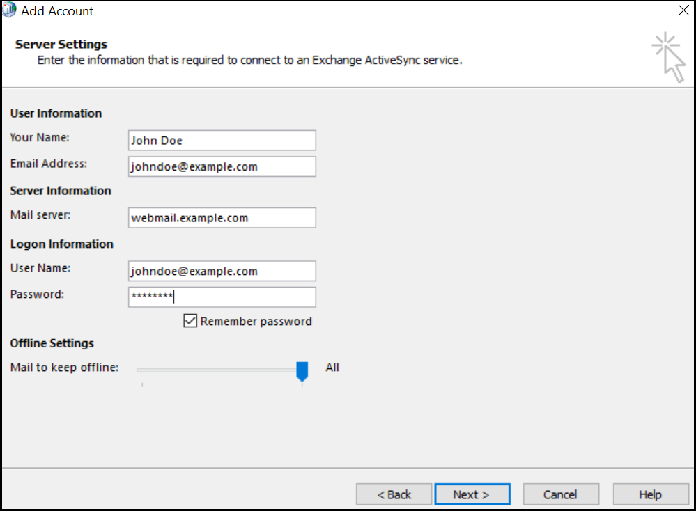

- Specify the mailbox credentials and press the Next button:
Note: For ActiveSync to work properly, only webmail.example.com must be used as the mail server.
