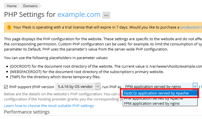

Perform one of the following actions in each domain of the affected subscription:
Change the PHP handler to FastCGI application: go to Domains > example.com > PHP and in the option run PHP as, change the handler from FPM application to FastCGI application, and click OK or Apply at the bottom of the page.
