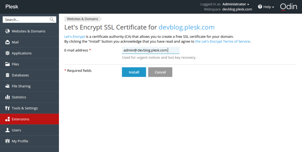

First, issued a free trusted certificate from Let’s Encrypt with automatic renewal and set it up for devblog.plesk.com, hosted on Plesk 12.5.
There are many manuals available online talking about how to install an SSL certificate on Linux so you might have already seen rows upon rows of command line calls, lists of changes to configuration files, and even instructions for building additional utilities. Well, we decided to make our life easier and just used the Plesk “Let’s encrypt” extension that enables Plesk users to issue and install certificates with auto-renewal functionality in the Plesk UI with just a few clicks.
You can find the details in one of our previous blog posts here: https://www.plesk.com/2015/12/lets-encrypt-plesk/. After a few clicks we were done and had a free, trusted SSL certificate installed on devblog.plesk.com. Let’s enable HTTP/2 next.

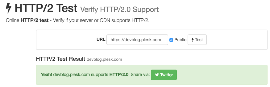

If you’d like to get a second opinion, you are welcome to use the “HTTP/2 and SPDY indicator” extension for Google Chrome, found here.

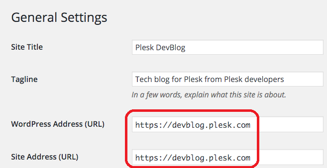

We have now secured the connection between the server and the website. Next step is to configure our WordPress site to only use HTTPS. This required a re-configuration of WordPress settings to replace all http:// links inside the WordPress database with https://. If you fail to do so you will continue to receive “Mixed content warnings” for previously uploaded content:
- Go to the WordPress administrative interface and change both “WordPress Address” and “Site Address” to use https://

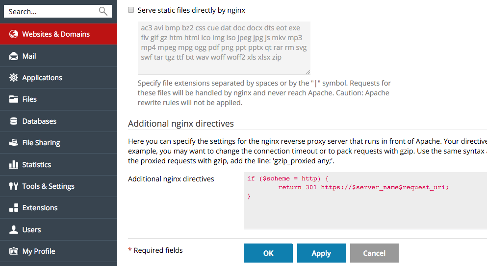

Last but not least we had to redirect all http:// requests to the https:// counterpart of our blog using the Plesk interface. We went to Websites & Domains , selected devblog.plesk.com, and then “Apache and nginx Settings”
to set-up the redirect in the “Additional nginx directives” section, like this:
if ($scheme = http) {
return 301 https://$server_name$request_uri;
That’s it! Now, all browser requests to https://devblog.plesk.com are redirected with the 301 code to https://devblog.plesk.com, and that’s just what we wanted.

It would be great if you showed us how to do a redirect for WIndows Servers.
Hey Votix,
You may find the answer here: https://support.plesk.com/hc/en-us/articles/115000327829-How-to-enable-redirection-from-HTTP-to-HTTPS-for-a-domain-in-Plesk
